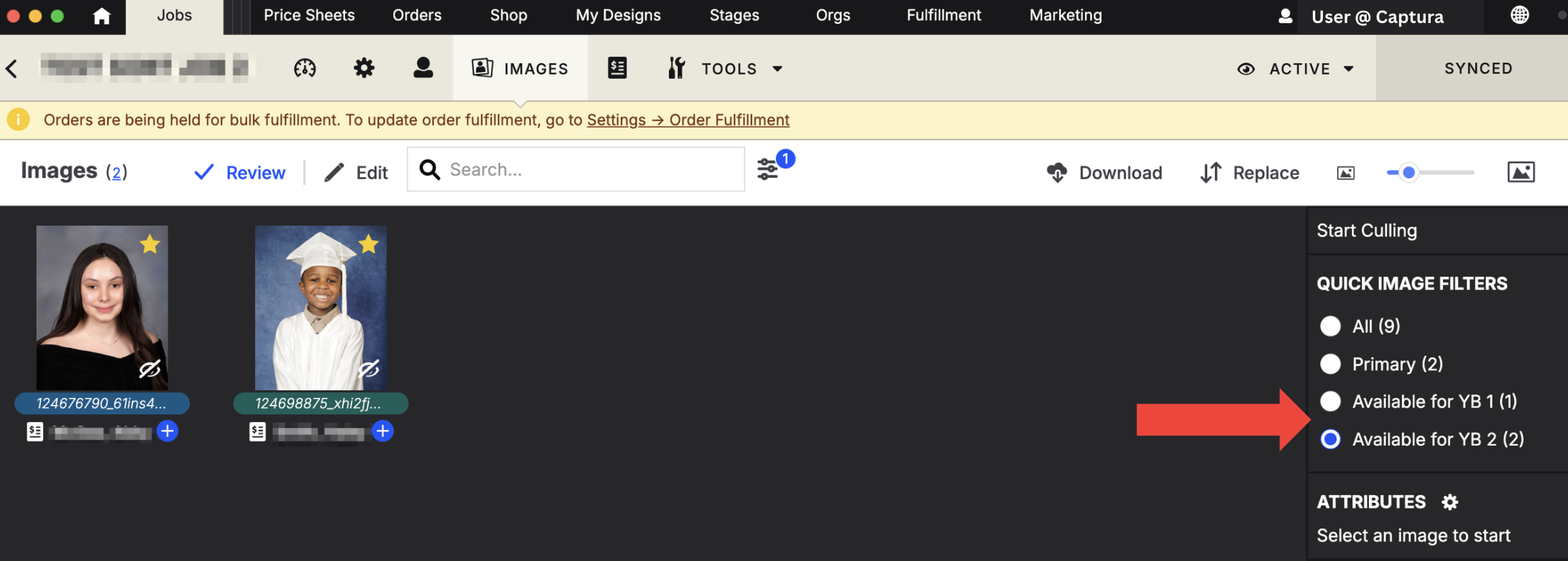

Quickly filter images with Yearbook Selection Attributes
Navigate to the Images tab inside your Job.
Click Available for YB 1 or Available for YB 2 under Quick Image Filters to view images available to customers for each yearbook pose selection.
