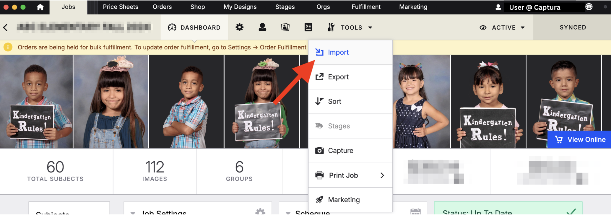

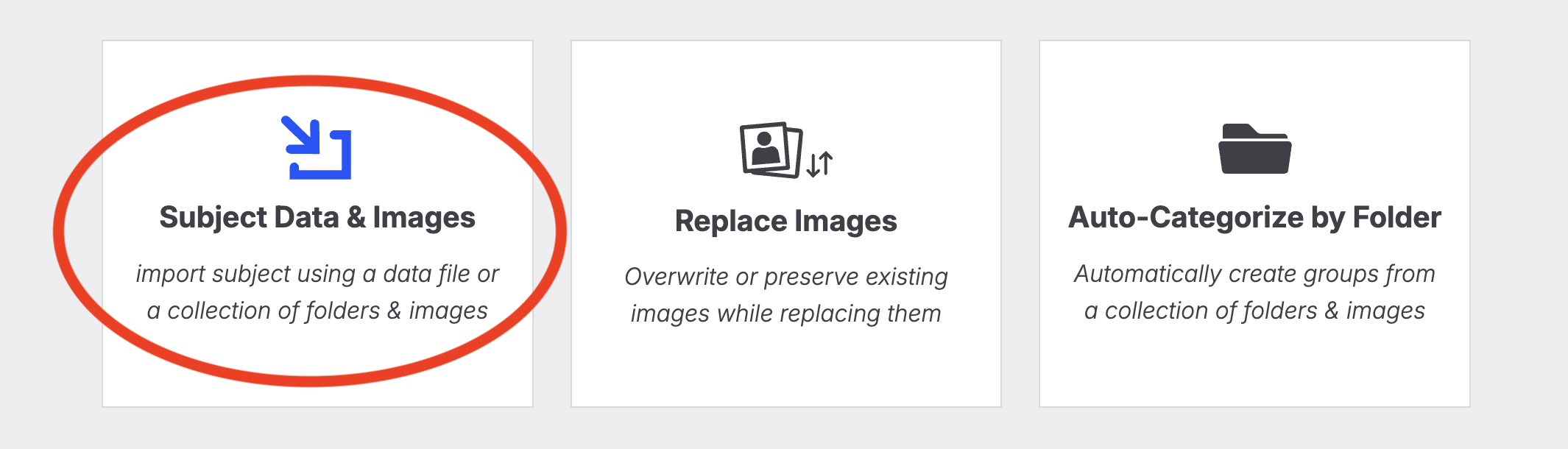

In a job, click on Tools > Import, then Subject Data & Images:

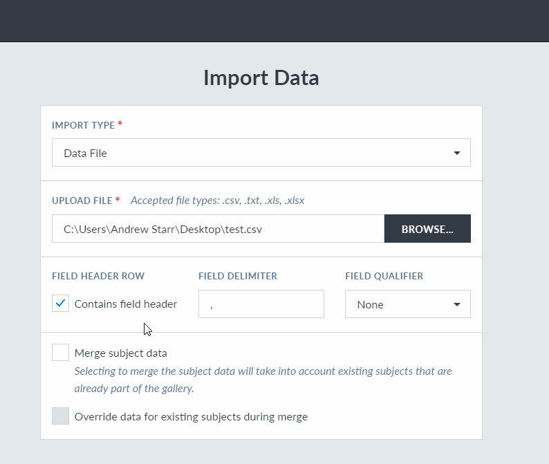

After you've specified the Import Type and Upload File Configuration, you have the option to specify if you'd like to merge the data with existing data in the Job and, if needed, override any existing subject data.
The important thing to keep in mind with importing Subject Data is:
Select Merge subject data if there is existing data in the Job you're importing to.
Select Override data for existing subjects during merge if there is existing data in the Job you're importing to and would like to update their information with what's in the data file.

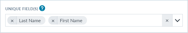

What are Unique Fields?
The second page of the Import Tool is the Match Columns to Subject Data section. Here is where you'll need to specify a unique field for Captura Workflow to compare the data in the upload file against existing subject data.
This field is useful for preventing Captura Workflow from accidentally creating duplicate subjects during the import process. During the import, Captura Workflow will skip creating a subject if an exact match is found in the unique fields for both the upload file and existing subject data.
PRO TIP: Most studios will use either the Subject's Online Code or Student ID as a guaranteed unique field per subject.
If Override data for existing subjects during merge is selected, Captura Workflow will still skip creating a subject if an exact match is found and update any mapped fields as needed.
