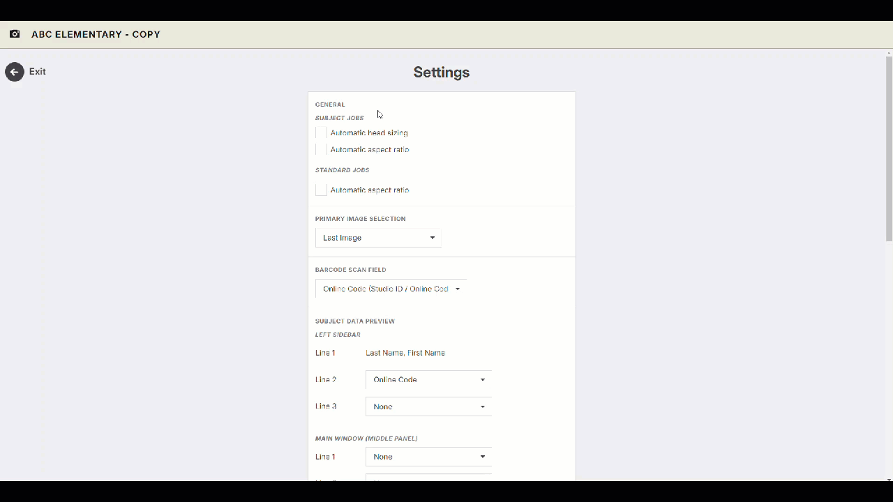

Enable watching in Workflow
In Workflow, open Settings β Camera Hot Folder and set your hot folder.
Check Enable watching for Captura Workflow to add new images as they appear in the folder.
βAll images taken at the shoot will remain in your hot folder.
π Note: βAfter syncing, Captura Workflow moves all images to a new "archived" sub-folder.
What other settings can I edit?
Enabling watching on the hot folder is the bare minimum needed for setup.
There are additional settings available to configure:
Setting | Detailed |
Automatic head-sizing |
Automatic aspect ratio | Select from the following aspect ratios to apply to each image automatically:
Primary image selection | Decide if the first or last image should be set as the subject's primary image. |
Barcode scan field | Choose the subject data field embedded in your exported barcodes to have Captura Workflow automatically select that subject when scanned.
Subject listing | Choose which subject-data fields you want to see in the subject list. |
Subject data preview | Select up to five different data fields to make visible in the middle pane when a subject is selected. These data fields can be updated on the fly as subjects come up to the chair. |

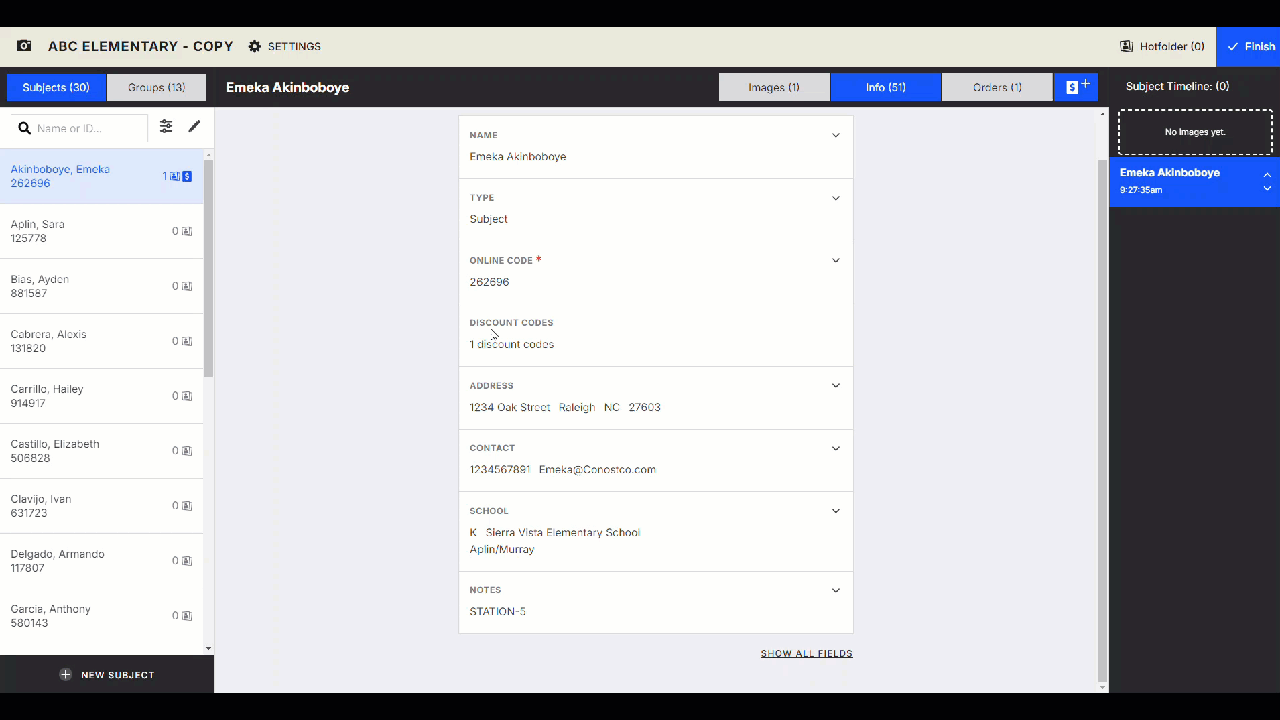

Managing subjects
You can easily create, edit or delete your subjects. After selecting a subject, click the Info tab to see all of your used subject data fields.
Here, you can edit or add any data youβd like. At the bottom of the Info tab, you can SHOW ALL fields to see all subject data fields available:

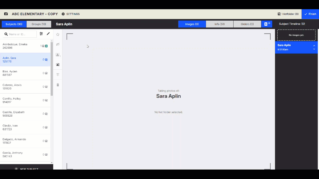

You can also create a new subject on the fly by using the New Subject button at the bottom-left corner of the application.
Use the filter button to apply filters to the subject list beside the search bar. As you photograph each subject, the list will filter out any applicable subjects instantly:

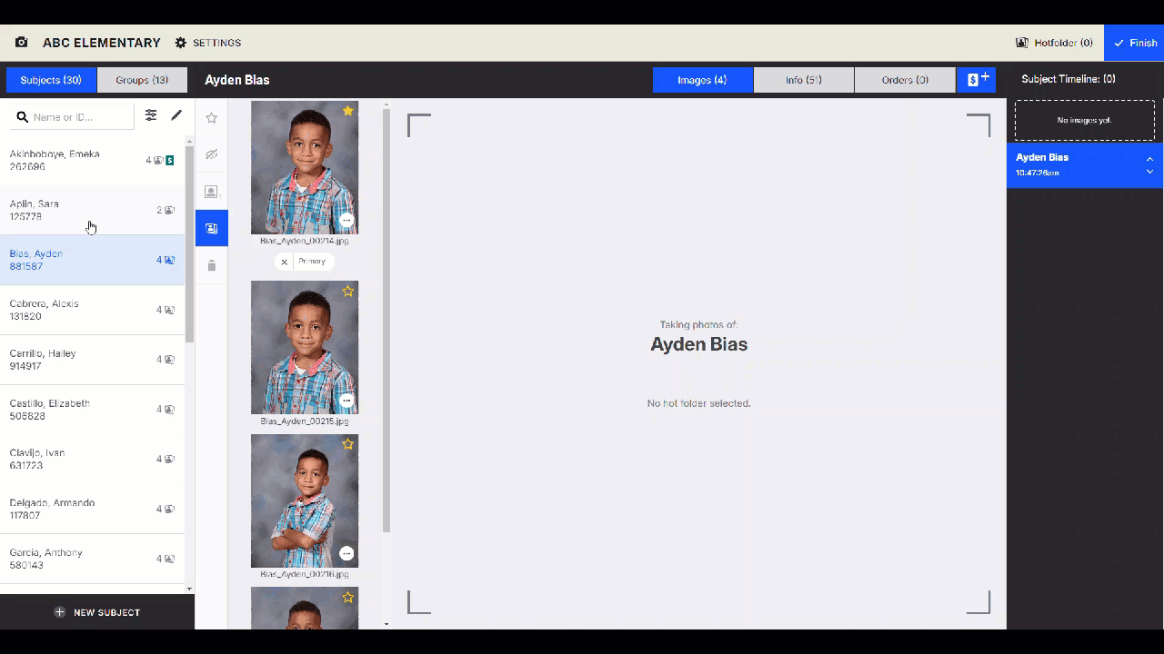

Taking photos while tethered

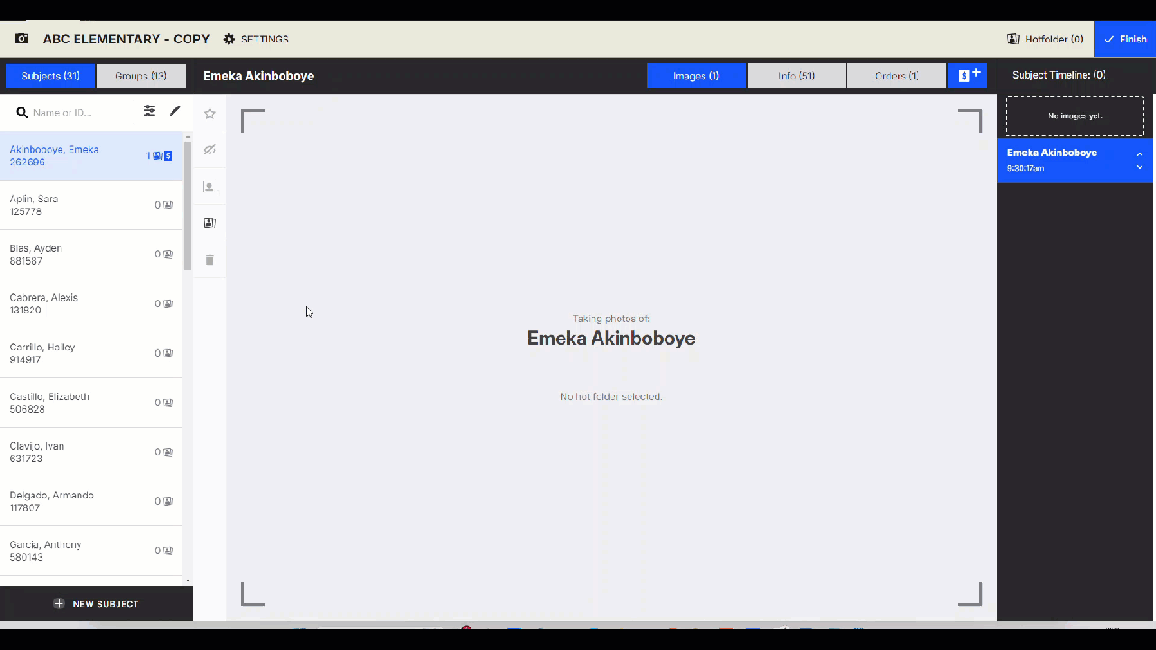

Once the subject is chosen or scanned, you're ready to take pictures. Take as many images as youβd like before moving on to the next subject. As you take pictures, you will see the image appear in the center pane and in the Subject Timeline on the right-hand side.
βThe subject timeline only shows thetimeline of the current session.
You can zoom in or out, change the aspect ratio on the bottom toolbar. The left toolbar also has several options to choose from.
