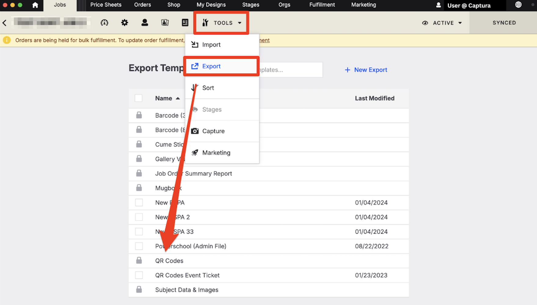

Export QR Codes from the job after you've imported and synced the subject data by clicking on Tools→ Export → QR Codes
Once inside the QR Code export template, start building your QR Codes by defining the sorting and grouping of QR Codes. You can also specify how many QR Codes should be printed per page. If you have a paper cutter, set your Stack Sort to the max number of sheets sliced per stack to keep the sorting accurate.
Add in any desired subject/studio data, as well as any custom text, to finish designing. You can see a preview of what a card will look like at the bottom as you start to make selections.
Next, choose where to save the PDF file and click Export to get your QR Codes.

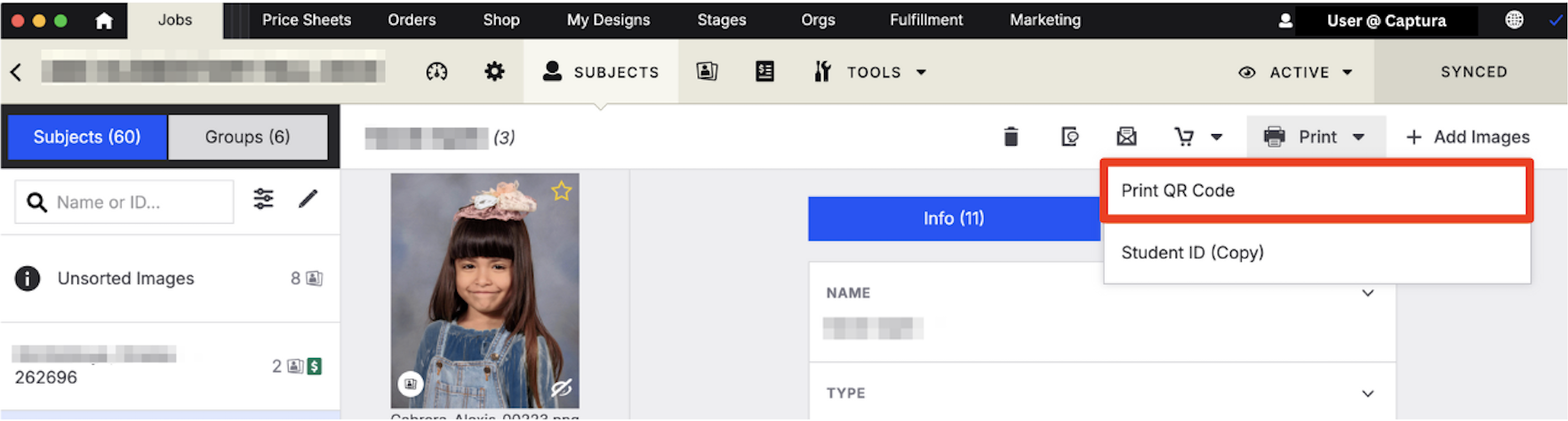

Select a subject in a job and click Print → QR Code
Add in any desired subject/studio data, as well as any custom text, to finish designing. You can see a preview of what a card will look like at the bottom as you start to make selections. Choose where to direct print or download the QR Code slate card.

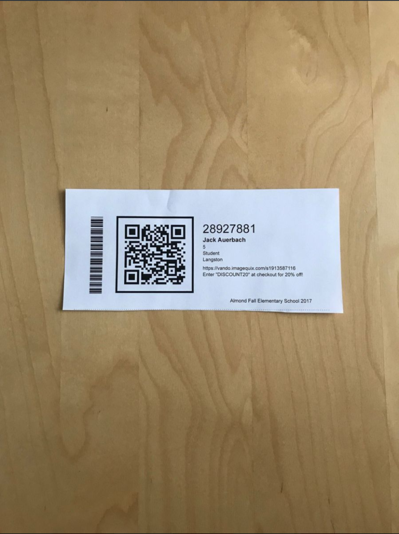

Take a picture of the QR Code before taking pictures of the subject. Each picture taken after the QR Code will be auto assigned to the subject the QR Code is attached with. We recommend the QR Code be shot from 3/5 distance like this:

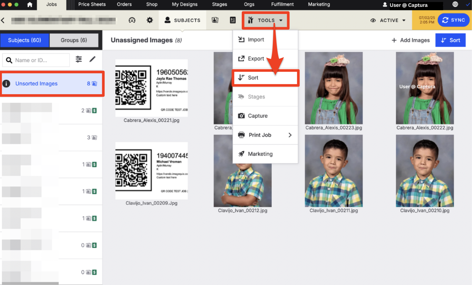

Add your images into your Unsorted Images and click Tools > Sort
Inside the tool, click on Autosort → QR Code → Sort to start sorting images to subjects.
Click Finish to exit the tool and sync your image assignment.
