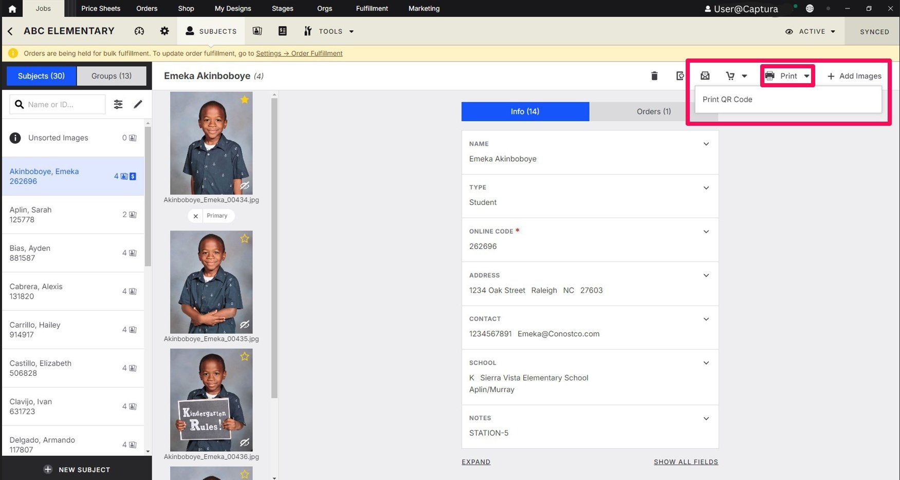

Printing a single QR Code
Select a subject from a job and click Print > QR Code:

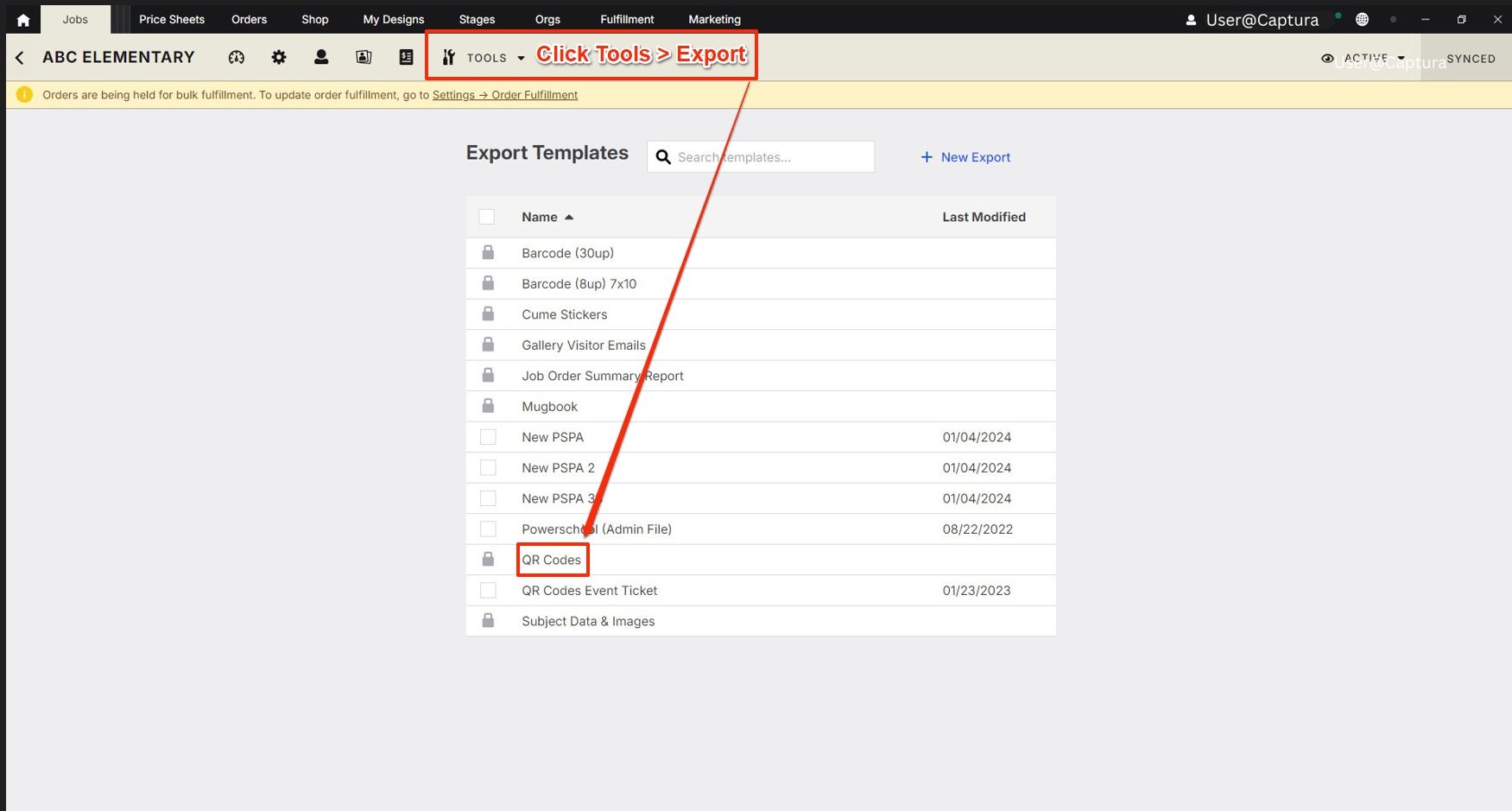

Batch exporting of QR Codes
In a job, click on Tools > Export > QR Codes:
Workflow will prompt you to set up the sorting, grouping, designing of your QR Codes before they can be exported. See Sorting, Grouping, and Designing the QR Code for more information.

Step 1: Access the Export Tool
  1. Navigate to the Tools menu inside the job.
  2. Select Export from the dropdown options.
  3. Choose QR codes from the export options.

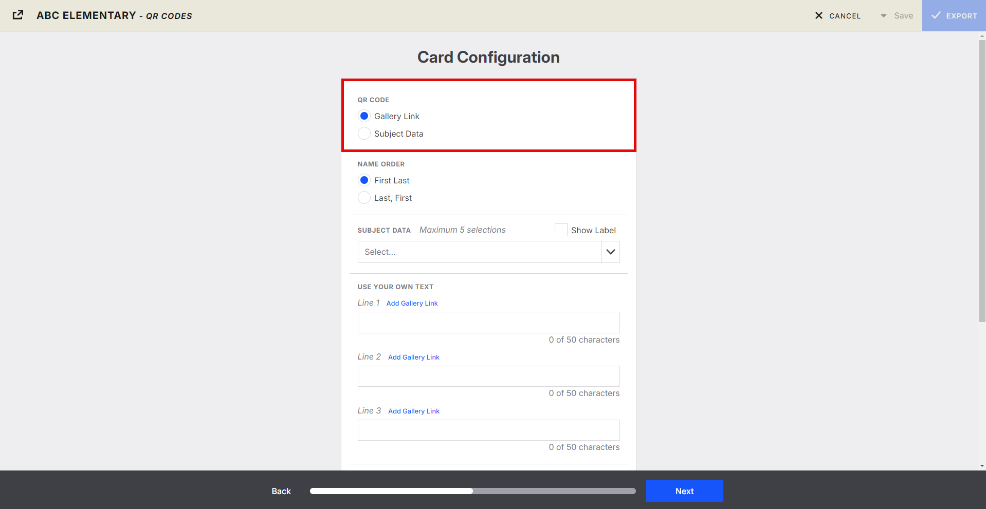

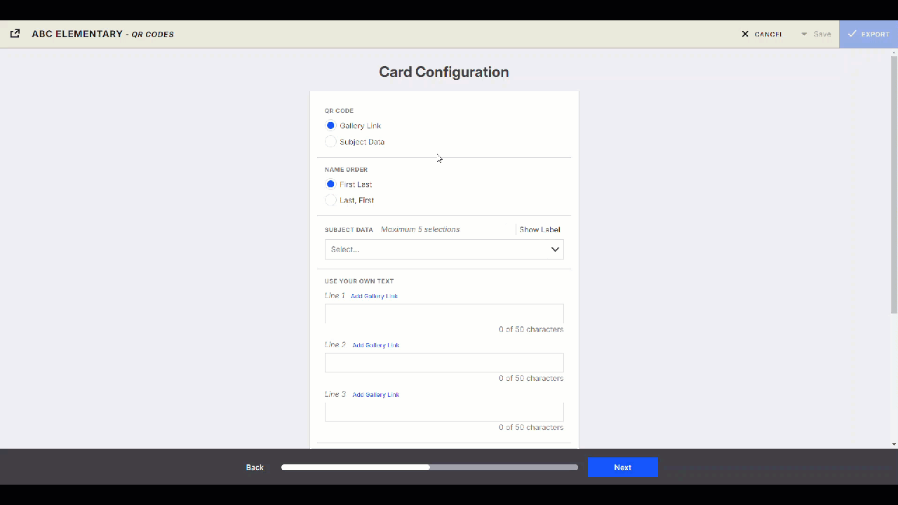

Step 3: Customize Card Content
In the "Card Configuration" section, you can define what information will be displayed on each QR code card. As you make selections, you will see a live preview of the QR code update, allowing you to visualize the final output.
  1. QR Code Functionality:
    • Subject ID or Gallery Link: This is a crucial setting. If you select "Gallery Link," subjects will be able to scan their unique QR code to directly access their online photo gallery.
  2. Content Customization:
    • Add Custom Text: You can include static text on the card for additional information.
    • Bring in Dynamic Data Fields: Leverage the data you've collected by adding dynamic fields (e.g., subject name, grade, etc.) that will pull specific information for each individual QR code. This allows for personalized cards.
    • Add Subject's Gallery Link: This option specifically allows you to embed the direct link to the subject's online gallery onto the card.

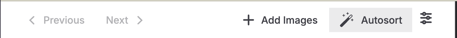

Click Tools > Sort. Once in, select +Add Images to add your images to the tool or drag and drop the images.
Once images are in place, click the Autosort button.
Workflow will now process and sort all images to their respective subjects:
  • QR Code images are automatically hidden from customer view.
  • If a QR Code does not match any subject, the images remain together "unsorted" for the studio to create a new subject or leave unassigned.
Click finish to exit the tool. Sync to upload the images and save your changes.

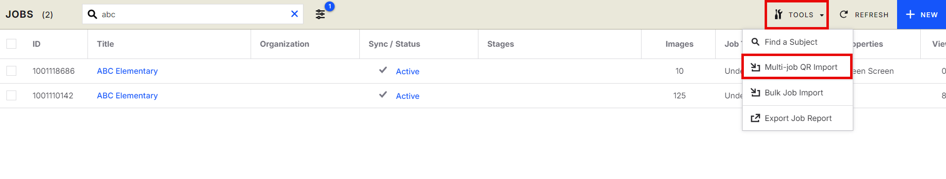

Multi-Job QR Import tool
The Multi-Job QR Import tool lets you sort and assign images to subjects/groups from multiple jobs in one motion. Copy all the images from multiple camera cards into one folder before starting.
From the Jobs tab, select Tools > Multi-Job QR Import:
Select a folder that contains QR workflow images and select Autosort.
Afterwards, the tool will let you:
  • Review and correct any image assignment as needed
  • Save a report of all images assigned/unassigned
  • Sync to upload images to cloud
